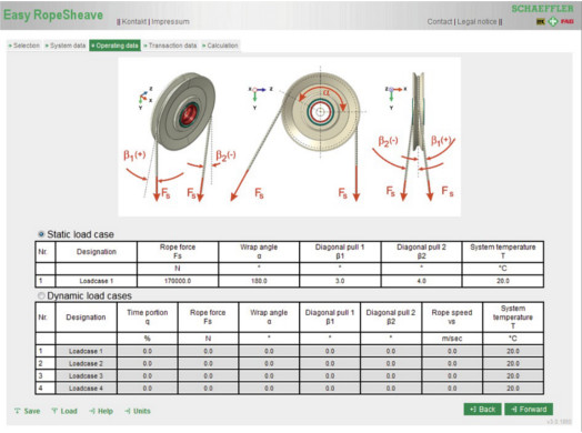

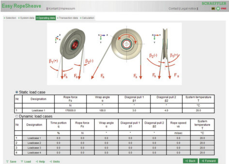

With “Bearinx®-online Easy RopeSheave”, Schaeffler customers can now calculate the static load safety factor and rating life of both single and multiple rope sheave bearings
With “Bearinx®-online Easy RopeSheave”, every Schaeffler customer can now calculate the static load safety factor and rating life of both single and multiple rope sheave bearings. It is available exclusively online and can be used free of charge. Initial registration takes very little time and the customer can begin calculation work immediately.
New: The “Easy series” for online customers
Customers can quickly and safely browse through and compare a range of bearing support variants at http:\\bearinx-online-easy-ropesheave.schaeffler.com. The self-explanatory menu navigation enables users to enter data quickly and easily for modeling, bearing selection, and operating data.
The calculation program is available exclusively online and can be used free of charge. Initial registration takes very little time and the customer can begin calculation work immediately.
The data for radial roller bearings, radial deep groove ball bearings, and radial tapered roller bearings from the INA and FAG brands are stored in the database and can be accessed and integrated into the calculation process at any time. Influencing factors that are typical for the application, such as consideration of the rope sheave material, the integration of a bush between the bearing and plastic rope sheave, precise data on the bearing’s internal geometry, and the influence of the system temperature on the bearing clearance are also relevant for the calculation.

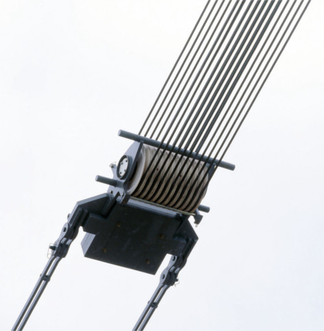

Bearinx® enables users to calculate, display, and document the specific bearing loads in detail while taking operating and environmental conditions into consideration – even for complex machine systems. The contact pressure on every single rolling element is considered in the calculation. There is a dedicated module for rope sheave bearing supports that allows even several adjacent rope sheaves to be calculated precisely. Bearinx® takes into account factors such as the non-linear elastic deflection behavior of the rolling elements, contact angle shifts in radial ball bearings caused by the load, the elasticity of the axis, and the real contact pressure depending on the skewing and profiling of the rolling elements.
Liebherr, one of the largest construction machinery manufacturers in the world, relies on Schaeffler’s bearing expertise. One Liebherr crawler crane, for example, is equipped with more than 100 SL04 cylindrical roller bearings from Schaeffler’s INA brand.
