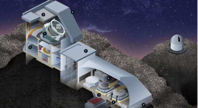

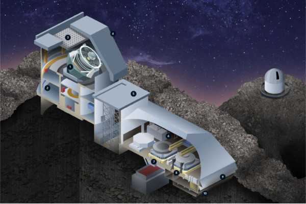

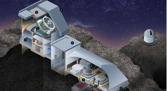

LSST main parts
1. 350-tonne telescope
2. 16-metre-long telescope pier
3. 11-metre-wide wind/light screen
4. 30-metre-high dome
5. 27-metre-high vertical platform lift
6. camera clean room
7. 75-tonne M1M3 telescope cell
8. coating chamber
9. control room
10. machine shop
