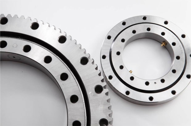

Figure 1: Silverthin™ Slewing Ring Bearing with classic Silverthin™ Thin Section Bearings

Both easy to mount and easy to maintain, the Silverthin™ Slewing Ring Bearings are able to be mounted via inner or outer ring with a range of mount hole types. They are also available ungeared, internally geared or externally geared to suit your application.

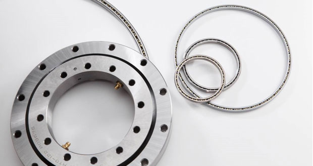

Figure 2: Silverthin™ externally geared and ungeared slewing ring bearings

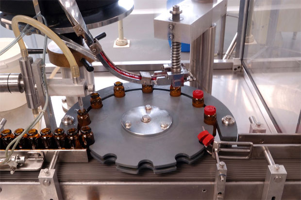

Figure 3: Slewing ring bearing application in a bottle carousel

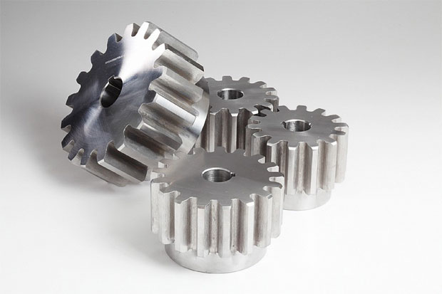

Silverthin™ also offers a series of pinions designed to mate with their slewing ring bearings allowing easy integration with your drive train. These pinions are made in AISI 4140 steel and are hardened to have a surface hardness of 50-60 HRc.
