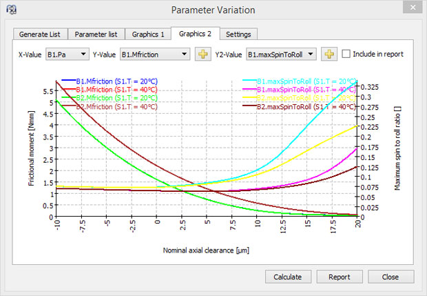

A second diagram shows friction moment and spin-to-roll ratio:
Friction moment and spin-to-roll-ratio dependent on bearing clearance
For the spin-to-roll-ratio often a limit of 0.25 is used. This would lead to an axial clearance Pa < 15μm. A smaller value for spin-to-roll ratio would be even better. The friction moment increases with the pretension (or decreases with the clearance).
As result of both diagrams the axial clearance should be selected as large as possible but smaller than 12μm. The calculation was done with medium tolerances for interference fits and one shaft speed. Now the shaft speed you be varied too and the calculation could be done with maximum/minimum values for interference fits between shaft and bearings. The example used a fixed displacement for pretension. Instead a spring could be used for generating pretension, then the spring stiffness would be another parameter to define.
Because of the high speed the result in this example is a positive bearing clearance. If a low shaft speed would be considered the optimum clearance would be negative, so there would be a pretension.
