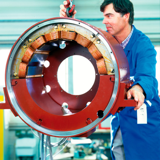

The SKF active magnetic bearing system levitates the rotating shaft and maintains it in position by applying controlled electromagnetic forces on the rotor in radial and axial directions.
The radial magnetic bearing stator comprises electromagnets, usually made of a stack of laminations with copper coils wound around the north and south poles. A current is applied to each coil to produce attractive forces on laminated iron rotor parts so to levitate the shaft inside the bearing. The clearance or magnetic air-gap between the stator and the rotor is 0.5 to 1.0 mm, depending on the application, thus there is no contact friction, no component wear and no lubrication required. The axial bearing design is similar but with solid iron stator cores and rotor parts, rather than laminated.
