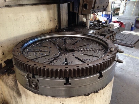

We, at Kavitsu Bearings, provide full refurbishment services to slew bearings up to 3000 mm diameter. Our state of the art facility ensures that the repaired bearing gives almost the same life, if not more, as compared to a new bearing. All this at fraction of cost for the new bearing. Please visit us at Kavitsu bearing repair if you need to get your bearing repaired. The only manufacturer in India to provide such services.
