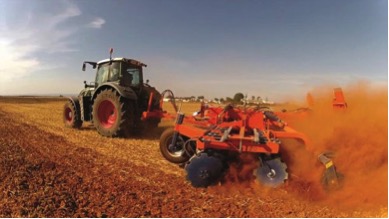

During seedbed preparation, the machine’s components are subjected to extremely high stresses, particularly the disc harrow segment of the so-called U-drill. The disc harrow is used to loosen and break up the soil before the following sowing coulters dig the furrows ready to receive the seeds.
The disc-shaped tools of the harrow are required to keep turning in all types of ground and at different soil depths. As a result of this low friction characteristics are highly important. The tools drive forward with working speeds of up to 18 km/h over uneven ground and must withstand any impact from stones. As the tools sit at an angle to the direction of motion, the bearings are exposed to high axial forces, not to mention environmental hazards such as dust, moisture, dirt and corrosive fertiliser.

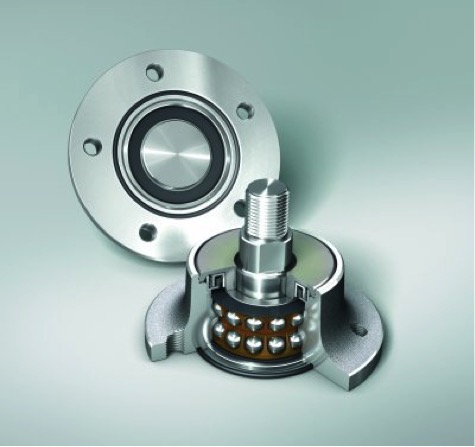

The Kverneland machines feature eight tools for each metre of working width. This means that they can be equipped with up to 48 highly stressed rolling bearings. To ensure the bearings are up to the job, the company today uses a robust and durable NSK solution, known as the Agri-Disc Hub.
Developed especially for use in soil cultivation and seeding machines, the NSK hubs comprise of a double row of angular contact ball bearings (featuring a 40° contact angle) with a separate inner ring that is designed to withstand high axial and tilt loads. Supplying an added-value solution, NSK fits the bearings into housings ready to be installed, thus simplifying assembly for Kverneland.
To overcome the challenge of sealing the bearing, NSK added a static seal with three sealing lips to the disc side (opposite the bearing housing) and a dynamic seal with two sealing lips between the bearing unit and the disc carrier. A large pressure plate provides further protection for the bearing and also serves to generate the desired pre-tensioning.
According to Kverneland, this innovative sealing system has proved to be highly effective, even with heavy dust, moisture and abrasive or corrosive elements in the soil such as sand and chemical fertilisers. Water projection tests have shown that even when subjected to high pressure cleaning, there is no reduction in bearing durability or longevity.
The bearing is filled with special performance grease which has a high pressure absorption capacity designed to last throughout the service life of the bearing. Despite heavy use, this feature makes any subsequent lubrication unnecessary saving time and grease whilst preserving the environment.

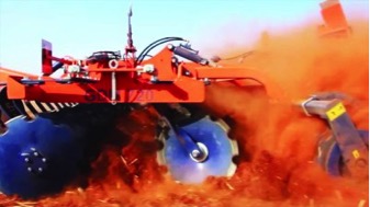

Galucho, the largest agricultural machinery manufacturer in Portugal and Spain, is now fitting Agri Disc Hub units from NSK to the company’s disc harrows. The move comes after two years of working together and testing the product on 700 hectares of land near Seville, a successful process that means NSK is now fully approved to assemble its Agri Disc Hub units on the disc harrows manufactured by Galucho machinery.
The latest disc harrow technology requires reliable bearing solutions to enhance quality, lower costs and protect the environment. As a consequence of the tough conditions faced by machinery used on farms, where working on all kinds of hard, dry and abrasive terrain leads to constant exposure to dirt, damp, vibration and impact, the potential for disc harrow bearings to deliver a long working life are limited. However, NSK’s Agri Disc Hub is designed purposely for agricultural applications.
The Agri Disc Hub is an extremely robust unit for disc harrows that meets agriculture’s requirements for greater productivity, reduced costs and environmental protection. The units comprise double-row angular contact ball bearings that are capable of supporting very high axial and radial loads. Any sudden impact caused by stones in the earth, for example, create high axial loads as a result of the angle at which the tilling equipment is positioned in relation to the direction of movement. Furthermore, abrasive material like dust, and corrosion caused by water and fertiliser, are known to cause problems for many conventional bearing solutions.
In contrast, Agri Disc Hubs extend the equipment’s working life without requiring maintenance (thus saving time), even during the severe mechanical stresses caused by agricultural use. This is thanks to a number of notable features, such as a highly efficient, optimised sealing system that stops abrasive dust and humidity from getting inside the bearings, even if the machinery comes into contact with manure or high-pressure water jets (during cleaning). It is also not possible for grease to drip on to the ground, as Agri Disc Hub bearings do not require additional lubrication, thus protecting the environment.
