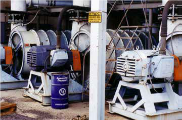

Application
The Spencer blower units are rated at 350 hp, running at 3,500 rpm. Each unit can put out 8,082 cubic feet of air per minute, up to seven days a week, 24 hours a day. The units are under a roof, but exposed to excessive heat in the summer.
Challenge

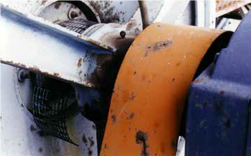

Grease recommended by the manufacturer was solidifying within 2,000 hours of installation in the bearings of these units. Staff was greasing the bearings daily, but still had to replace them frequently. Each pair of bearings cost about $1,000, plus the labor and downtime to replace them.
The last time the bearings went out, Raymond Schultz Jr., plant superintendent, noticed that the manufacturer’s recommended grease had turned to a “rubbery-looking solid” in the 6-inch diameter bearing races.
LE Solution
The local LE consultant recommended Almaplex® Industrial Lubricant (1275), an excellent general purpose EP lubricant for industrial or fleet use. It is effective in severe operations against moisture and high temperatures, seals out dirt and prevents corrosive wear. Almaplex 1275 contains Almasol®, LE’s proprietary solid wear-reducing additive.
Results
Since they began using Almaplex 1275, the plant maintenance staff is noticing longer bearing life and better performance. The City of Brenham is saving money each year on fewer bearing replacements and reduced downtime.
“Frequent replacement of bearings is a thing of the past, thanks to the use of LE’s Almaplex Industrial Lubricant,” Schultz said.
