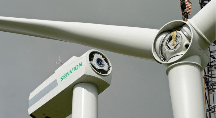

New generation of blade bearings in the 3.4M 140 EBC wind turbine by Senvion.
