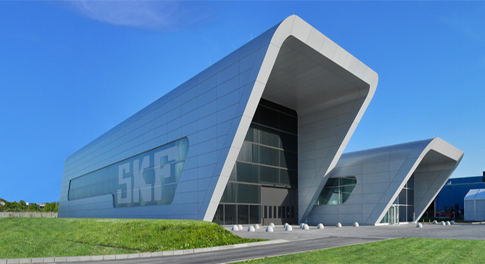

The Sven Wingquist Test Center is home to two gigantic rigs. They enable accurate testing methods that will support the proprietary improvements in large size bearing design.

A center for sustainability
The Sven Wingquist Test Center has been built to the most advanced environmental standards possible. With test run time reduction due the unique capabilities of the test rigs, there is huge potential for energy savings. Another contribution to environmental friendliness is the fact that waste heat is recovered and fed into the heating system of the SKF factory close by. This resource- saving capability of both test rigs has gained the support of the German Federal Ministry for the Environment, Nature Conservation, Construction and Reactor Safety, as well as the support of the Bavarian Ministry of Economics and Media, Energy and Technology.
