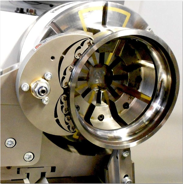

RON Centric01wRON-Centric is the latest generation of the centerless shoe-type grinding technology. It keeps all advantages of traditional technology and eliminates its main drawbacks.
RON-Centric provides much better flexibility, accuracy and productivity in the same time.
RON Centric02wRON-Centric is a tooling system replacing the traditional Microcentric shoes. This technology is based on the unique concept of multipoint centering. Design of the side shoe is mathematically optimized to correct roundness errors. The monolithic, precision shoe is made of the high strength titanium alloy and has six internal degrees of freedom, provided by the frictionless flexible hinges.
RON-Centric design guarantees suppressing of any roundness deviations for 2 through 500 lobes (harmonics)! Because of the optimal internal structure, RON-Centric system does not need any optimization of the alpha-beta angles.
The side shoe is always fixed on the level of spindle centers (180 degrees from the grinding point). Position of the bottom shoe is not very important and varies. As a result RON-Centric provides many additional advantages, which are critically important for the higher total efficiency:

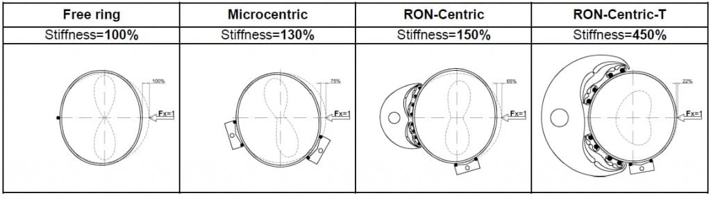

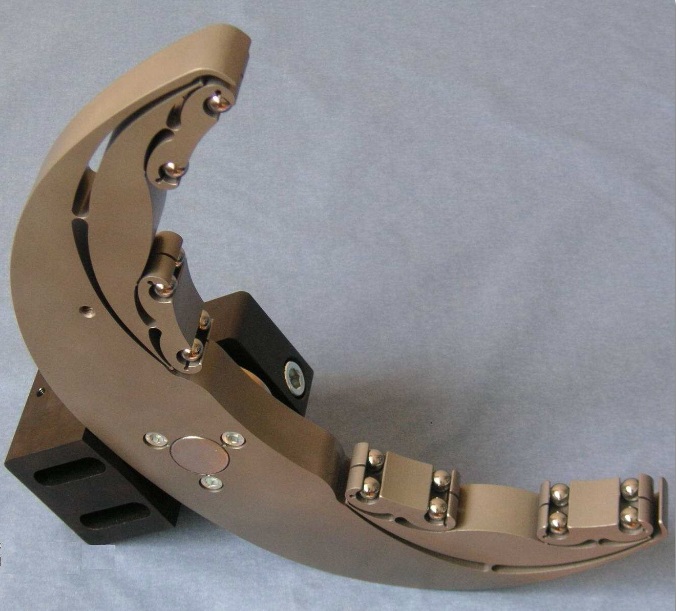

Most of all the troubles are associated with the thin walled rings. Such rings get much greater deformations after heat treatment than heavier ones. So their initial roundness before grinding is worse. In the same time it is very difficult to improve roundness by grinding because these rings have low stiffness. Manufacturers use long and multi-step grinding cycles to solve this problem. Some of thinnest rings are so flexible that it is impossible to grind them with Microcentric technology at all. They should be fixed on a mandrel to be ground. This technology has low productivity also. In addition rings change roundness after removing form the mandrel. RON-Centric-T is a real revolution in this field. This shoe system is based on the same ideas and mathematical models as the basic RON Centric version. It keeps all main RON-Centric advantages. But its parameters are optimized to increase total stiffness first of all. The RON Centric-T shoe has much longer contact with the supported ring than a standard shoe. Because of this fact it suppresses roundness deviations for 2 through 150 lobes only. But it increases the total stiffness 3 times!!! The bottom table compares stiffness and deformation of the ring in various shoe systems under the equal force.
RON Centric05w
  • RON-Centric-T reduces processing cycles in several times, often – from hours to minutes.
  • It provides the excellent roundness for very thin rings (unattainable by other technologies).
  • The new types of ultra-thin rings can be ground easily on the RON-Centric-T shoes without any mandrels.
