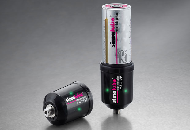

Now available! simalube® IMPULSE is the perfect complement to the well-established simalube lubricator – wherever high pressure is required. It has no problem overcoming counterpressures of up to 10 bar, making it the perfect solution for high counterpressure and long lubrication lines. Simply affix the simalube® IMPULSE to the lubrication point, then screw on the required simalube lubricator and activate it for the desired dispensing time. The simalube® IMPULSE requires no additional adjustments and the LED display continuously signals its proper functioning. Once it is completely empty, the simalube® IMPULSE can be used multiple times if it is equipped with a new simalube lubricator and battery pack.
simalube IMPULSE – pressure booster up to 10 bar
Impressive functionality
The simalube® IMPULSE, together with simalube lubricators in sizes of 60, 125 or 250 ml, ensures reliable lubrication when faced with high counterpressure and lubrication lines of up to four metres. Continuous lubrication impulses of 0.5 ml supply the lubrication point with oil or grease up to NLGI 2 at a pressure of up to 10 bar. This action is gentle on the lubricant, as only the dosing volume is placed under pressure. The intelligent pressure booster also continually signals its operating state. When properly installed, the LED indicator on the simalube® IMPULSE flashes green at regular intervals. Red flashes signal overpressure, inactive and empty conditions.

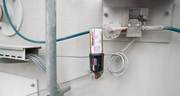

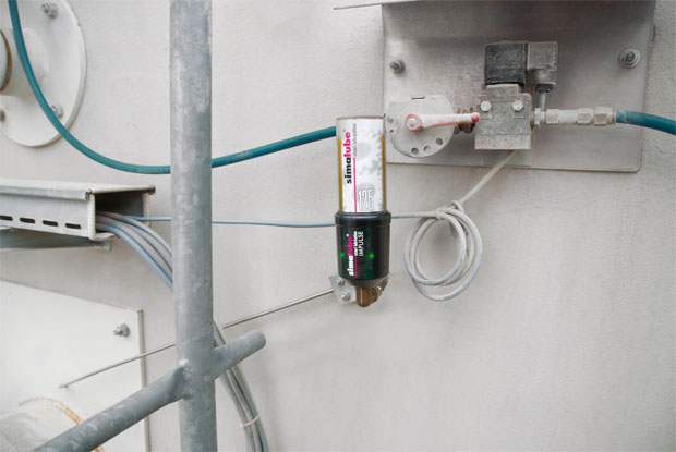

The simalube IMPULSE with a 125 ml lubricator is used in gravel plants. The IMPULSE pushes the lubricant with a pressure of 10 bar through a 4-metre lubrication line.

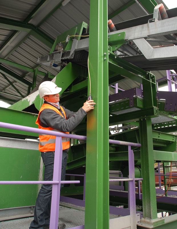

A maintenance specialist installs the simalube IMPULSE at the end of a long lubrication line at a convenient working and monitoring height (at 3.5 m above the ground the lubrication point is unreachable).
