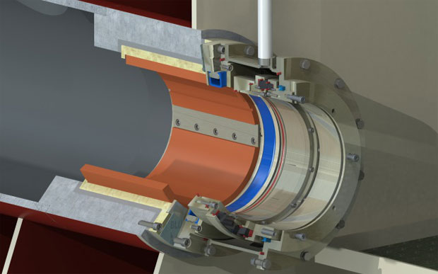

A CAD drawing of the COMPAC shaft bearing system.
“More and more shipowners are realising that water-lubricated propeller shaft systems not only meet US EPA rules governing the use of Environmentally Acceptable Lubricants (EAL) but its use can also reduce operational costs. Seawater-lubricated bearing technology negates the purchase, storage and disposal of costly mineral and synthetic oils.”
The US Environmental Protection Agency is enforcing regulations introduced in December 2013 that stipulate all vessels over 24m operating in US waters must switch over to EALs in all oil-to-sea interfaces before their next dry docking.
“When used in conjunction with the COMPAC bearing system, seawater – an approved EAL – lubricates the bearings to ensure the smooth, effective and safe operation of the vessel. Not only do we guarantee our seawater-lubricated system for a wear life of fifteen years, but it reduces substantially a shipowner’s annual operating and maintenance costs, compared to an EAL-lubricated metal bearing and two seal system,” continued Carter.
