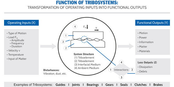

One of the most important pillars of tribology is the system analytical and system related thinking.
Tribological systems 123
Friction and wear are not material properties. They are responses to a specific tribological system which typically includes a bearing, shaft and lubricant combination and as such are influenced by a wide range of factors. The tribological sub-system in Figure 1 provides an overview of common factors which affect friction and wear values:

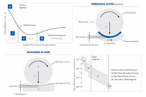

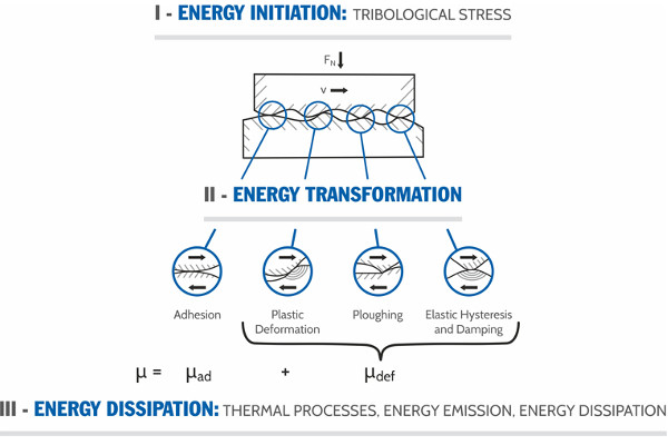

What is friction?
Friction is the force of resistance to motion between two bodies in contact. Friction can be described on the macroscopic level by the basic laws of friction from physicists Guillaume Amontons and Charles-Augustin de Coulomb. These physicists found a linear relationship between resulting friction force and applied normal load. Based on this, a dimensionless main parameter can be derived, called the coefficient of friction. It is defined by the ratio of the resulting friction force and applied normal force.
However, the actual mechanism of sliding friction occurs at a microscopic level, which means tribological theories on friction also involve the topography of the surfaces. The tribologist differentiates between the real contact area and the nominal contact area (geometric dimensions), which accounts for any voids or non-contacting portions of a solid element. The mechanisms responsible for the energy transforming process in the near surface area include:

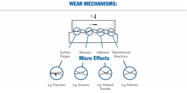

What is wear?
Wear is defined as the irreversible material loss of interacting surfaces. Physical and chemical elementary processes within the area of contact of a sliding pairing subsequently leading to change in material and shape of the friction partners are known as wear mechanisms. These wear mechanisms include:
µ=f(tribo-structure(t),induced collective stress(t))
w=f(tribo-structure (t),induced collective stress(t))
Friction and wear mechanisms do not occur in an isolated fashion, but rather through a superposition of mechanisms that is challenging to quantify and control for. This superposition occurs in tribo-technical systems in non-detectable proportions and in proportions that vary across time and place, making it nearly impossible to calculate friction and wear processes in a tribo-contact. This is why tribological tests are so crucial for estimating tribological behavior. If we want to interpret and understand tribologically-measured data and mechanism-oriented research, we need complete knowledge of the acting mechanisms in a tribo-contact.
Tribologists classify friction, wear and lubrication conditions according to the following schedules:
- Friction Regime 0: Solid friction: Friction is created between direct contacting solid surfaces without any lubricant.
- Friction Regime I: Boundary friction: Solid friction, in which the surfaces of the friction partners are covered with a molecular lubricant film that has no load carrying capacity. The Lubricant has an influence on the friction and wear characteristics.
- Friction Regime II: Mixed friction: Friction regime I and III co-exist. The friction value is a combination of solid and hydrodynamic friction. A fluid film created by the lubricant has a load carrying capacity.
- Friction regime III: Hydrodynamic friction: Friction value is determined by shearing in the fluid. The load carrying capacity of the fluid film prevents direct contact between the two solid surfaces.
- Wear regime a: High wear rates due to solid friction and direct contact of surfaces.
- Wear regime b: Lower wear values due to a molecular fluid film.
- Wear regime c: Mild wear due to a partial separation of the surfaces through a thicker fluid film.
- Wear regime d: “Zero wear,“ resulting from hydrodynamic or elastohydrodynamic fluid films that prevent direct contact of the two surfaces.

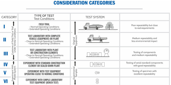

When designing experiments describing friction and wear, tribological testing can be placed into one of six main categories, from field tests in Category I to simplest laboratory model tests Category VI.
Category I: A field trial is conducted under normal operating conditions, which may include extended operating conditions. This results in poor repeatability but is close to real world requirements the tribological system will face.
Category II: Experiments are undertaken with a complete piece of equipment in a plant environment. These experiments may achieve results close to normal operating conditions and can be conducted over a period of time to replicate extended operating conditions while limiting environmental impact.
Category III: Components, subsystems or assemblies are tested in a laboratory approximating normal extended operating conditions, yielding medium repeatability
Category IV: Laboratory testing is conducted on serial standard components using scaled down testing plant apparatus.
Category V: Experiments are conducted on a specimen with test equipment to deliver close to normal operating conditions with excellent repeatability.
Category VI: A bench test is conducted with simple laboratory test equipment.
It is important to remember that in categories I through III, the system structure of the original tribo- aggregate remains consistent, and only the collective stress is simplified. Categories II and III offer more reproducible collective stresses than category I. In contrast, in categories IV through VI, the system structure is simplified with the disadvantage of decreasing predictability in the transferability of test results to comparable practical tribo-technical systems. Categories IV through VI offer better metrology of the sub tribo-contact, lower cost and a tighter testing timeframe.1 So with an ascending order of the test categories the test time as well as the test cost increases significantly, but transferability of the test result increases as well.

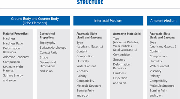

HOW DOES THE CONDITION OF A SHAFT AND THE TRANSFER LAYER IMPACT TRIBOLOGICAL PERFORMANCE?
Because the shaft is an essential element of the tribological system structure of the bearing sub-system. Its properties have a direct impact on friction and wear as well as on all other occurences in a bearing/shaft contact. Essential shaft properties include:
- Materials and their chemical and physical properties
- Geometrical properties including topography and contact ratio.

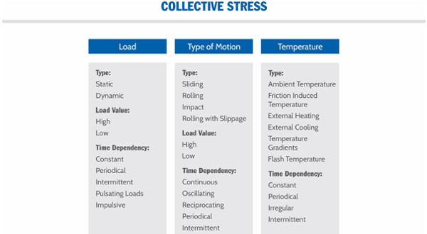

WHAT TRIBOLOGICAL FACTORS NEED TO BE CONSIDERED IN BEARING SELECTION? HOW DO THESE FACTORS AFFECT BEARING SELECTION?
The scope of the tribological system is of essential importance in bearing selection. A high level overview of considerations would include the following
1. The induced collective stress including:
- Nature of the load
- Nature of the motion
- Temperatures
- Time factor
2. The mating partner:
- Materials, including physical and chemical properties
- Geometrical features including the contact ratio and topography (roughness, isotropy and anisotropy)
3. The interfacial medium and its property profile
4. The ambient medium and its properties
