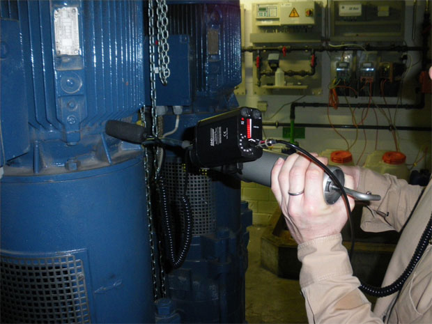

Typical applications for ultrasound include compressed air & gas leak detection, electrical inspection of energized electrical equipment to detect corona, tracking, and arcing, steam traps, and mechanical inspection of rotating equipment including condition based lubrication with ultrasound.
Bearing Lubrication with Ultrasound
There are various sources of ultrasound. In regards to compressed gas leak detection, turbulence is created when the high pressure leaks to the lower pressure atmosphere. The source of ultrasound with bearing lubrication is friction. When there is an increase in friction, there is an increase in the decibel level or more noise.
When a bearing is in a lack of lubrication state, there is an increase in both friction and noise. When using the ultrasonic instrument, the inspector listens to the bearing and watches the decibel level on the instrument. As grease is applied, there is less friction and less noise. Once a proper lubrication level is reached, the dB level will remain steady and constant. If grease continues to be applied, the dB level will gradually start to increase. At this point, lubrication would need to cease because the threshold for over lubrication has been reached. An over lubrication condition also increases both pressure and friction inside the housing, thus creating more noise.

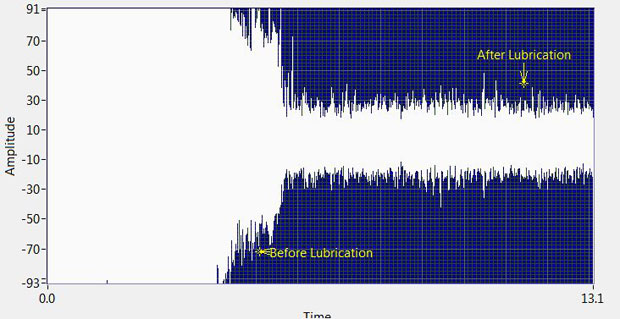

The image above is the time series view from a recorded ultrasound of a bearing in the process of being lubricated. The sound file was approximately 13 seconds in length. Notice the before lubrication on the far left, compared to the after lubrication on the far right.

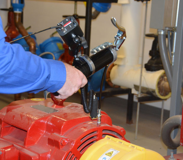

The UE Systems Ultraprobe 401 Digital Grease Caddy Pro is the perfect tool for ultrasound assisted bearing lubrication.
- 1. More bearing problems will be found because PM’s will be done while listening to the bearing rather than just going out with a grease gun and not listening to the bearing.
