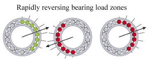

Aligned (green) rollers are in a load zone. Misaligned rollers (red) are 180° to the loaded ones. In a transient torque reversal, unaligned rollers are suddenly loaded, then unloaded, and repeatedly in a short period.

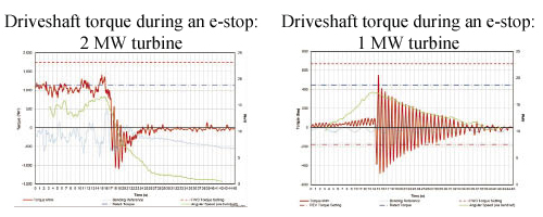

Left: The red trace plots a high wind TTR event on a 2 MW wind turbine. At about the 17 sec mark the torque rapidly transitions from positive to negative. This torque transfers right through the gearbox bearings.
Right: The red trace plots a high wind TTR event on a 1 MW wind turbine during an emergency stop. At about the 15 sec mark the torque oscillates from positive to negative.

Rapid torque reversals
What is it about a turbine drivetrain that causes it to be so susceptible to the rapid and severe torque reversals? This has to do with the relative rotating masses (inertias) of the blades and the generator rotor, and how they can react against each other within the torsional natural frequency of the drive system. A typical turbine has 80 to 90% of its relative inertia in the blades, with most of the rest of the inertia in the generator rotor. In normal operation, the blades are driving the generator in the positive direction. A grid disconnect, emergency stop, or high-wind shutdown triggers rapid aero braking of the blades that attempts to decelerate the drive system. Most of the aero braking effort goes into decelerating the massive blade inertia, but some of it goes through the drive system to decelerate the generator. This typically causes a torque reversal in the drive system that can result in the inertias of the system winding up and unwinding against each other several times at the torsional natural frequency of the system as it decelerates. Note: The 1 and 2 MW turbines have similar natural frequencies despite the significant size difference in the turbines. How do these reversals cause impact loading in the bearings?
Rapidly reversing bearing load zones and impact loads on misaligned rollers, damaging to bearings in other types of equipment, can cause WEA damage. Rapidly reversing bearing load zones are also known to decrease bearing life. During TTRs, every bearing in the gearbox sees a rapid load zone reversal of almost 180° that can cause severe impact loads between rollers and raceways. All the cited research recognizes that impact loading could be the source of the stress-induced subsurface WEA damage, and most of the findings name it as a suggested leading candidate.
Field testing demonstrates the ability to reduce the maximum reverse torque and rate of torque increase. This method can also dampen torsional vibrations to reduce the number of reversals to 40% of nominal torque.
During normal operation, rollers in the bearings are aligned and rolling at the expected or design speed while they are in the load zone. As they leave the load zone, the rollers slow down and can misalign within the tolerance of the cages. As they approach the load zone again, they are gradually brought back into alignment and smoothly accelerate to support the load. In a rapid load zone reversal, the unloaded rollers opposite the normal load zone are suddenly loaded while in this misaligned state. This rapid loading increases the load concentration of the rollers in the middle of the inner race.

High-resolution torque reversal recordings of wind turbines reflect the rate of change in torque. The steeper slope indicates significantly higher strain rates.
Axial cracking issues in bearings were not a prominent failure mode until larger megawatt and multi-megawatt class wind turbines were put in service. It was not a common failure mode of earlier, smaller turbine models where the failure mode was more commonly bearing surface deterioration from pitting and scuffing. The issue of axial cracking grew along with turbine size.
To understand why, it is important to zoom in on the field data to look at the first quarter of a second of the worst torque reversals that were recorded on three different size wind turbines. The graph Comparison of torque reversals recorded on three different sizes of wind turbines compares the relative torque magnitude and the rate of torque change during rapid reversals. High-resolution torque monitoring equipment recorded torque reversals that approximated the turbine rated torque at the high-speed shaft on 0.75, 1, and 2 MW turbines. The torsional natural frequencies of the turbines during aero braking were all similar with oscillation periods about 0.75 second-per-cycle. Higher torque loads of the larger turbines can be accommodated in the sizing of the bearings but the oil film thickness will not increase. Any roller misalignment easily causes higher local-contact stress during a torque reversal. The difference in the rate of increase of the reverse torque during the torque reversal may be an even bigger factor, as it directly relates to the strain rate in the raceway as the rollers impact. Both the higher stress and the faster strain rate increase the instantaneous plastic deformation energy.
