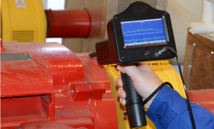

It has been established that ultrasound monitoring provides early warning of bearing failure. Various stages of bearing failure have been established. An 8 dB gain over baseline indicates pre-failure or lack of lubrication. A 12 dB increase establishes the very beginning of the failure mode. A 16 dB gain indicates advanced failure condition while a 35-50 dB gain warns of catastrophic failure. For those who utilize ultrasound spectral analysis, these conditions can often be observed through both Fast Fourier Transform (FFT) and time series analysis.
This is possible using an ultrasound instrument and special sound analysis software. UE Systems Ultraprobe 10000 and Ultraprobe 15000 are able to do sound recordings that can be later analysed in its license-free software Spectralyzer.
