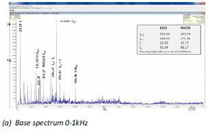

An example of such a vibration measurement is shown in Figure 30. As part of Schaeffler UK’s studies, a 1.2MW gearbox was run at 1500rpm on a purpose built test stand and vibration measurements were obtained at various positions on the gearbox housing.
Figure: 30a
The vibration spectrum obtained from the housing close to the high speed shaft (HSS) is shown in Figure 30.

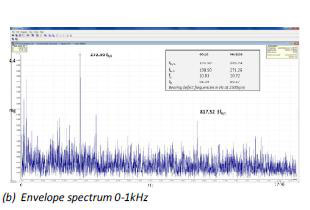

The calculated BPFI (Ball Pass Frequency of the Inner race) for the type NU228 cylindrical roller bearing on the high speed shaft (HSS) was 271.26Hz and present in the spectrum is a large amplitude vibration at 270.64Hz, which matches very closely with the calculated frequency. Either side of the vibration at 270.64Hz are a few sidebands at shaft rotational speed (fs = 25Hz). In the envelope spectrum, Figure 30(b), the BPFI is also evident at 272.50Hz, along with the third harmonic (817.52Hz).
Figure: 30b

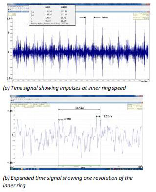

This indicates that some damage may be present on the inner ring raceway and the absence of any significant harmonics of BPFI suggests that the damage is fairly localised. This is further supported by the impulsive nature of the time signal, Figure 31(a), showing impulses at the output rotational speed (40ms, 25Hz).
Figure: 31 a&b
Figure 31(b) shows the expanded time signal where during one revolution of the inner ring, the contact of the roller with the defect is clearly visible (~3.52-3.9ms).
As a result, the gearbox was dismantled and examined and a localised fault was found on the inner ring raceway of the type NU228 cylindrical roller bearing.
This damage occurred during the assembly process, the most likely cause being misalignment between the inner ring and outer ring/rollers as the inner ring-shaft and outer ring-housing were aligned and assembled together.
During running of the gearbox on the test stand, all the operating temperatures were normal and this damage would otherwise have gone undetected without the vibration measurements. Such damage would result in a shortened service life and premature failure of the gearbox. In this case, the value of a detailed vibration analysis is obvious; in the long run, this saves the customer both time, money and reputation.
