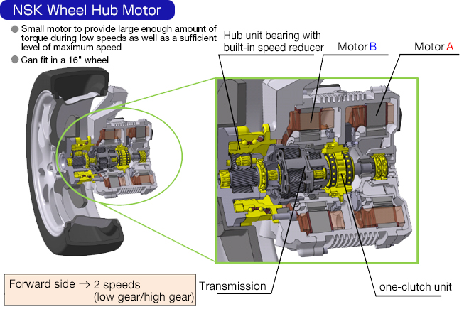

In order to make in-wheel motors more compact, NSK developed a transmission-equipped wheel hub motor that uses two motors and a special transmission.
This wheel hub motor is equipped with two motors and a transmission composed of two planetary gears, which can achieve both high drive torque and a sufficient maximum speed with a small motor. In addition, this transmission has a feature (Fig. 3) that enables smooth gear changing even during acceleration by controlling the speed and torque of the two motors. For the first time in the world, NSK demonstrated the superior performance of this technology using an experimental vehicle (Fig. 4) equipped with a prototype wheel hub motor.

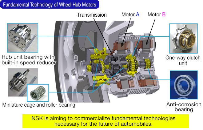

Building upon the knowledge gained with its prototype wheel hub motor, NSK aims to understand the required level of performance of components (Fig. 5) such as the hub unit bearing with built-in speed reducer, the one-way clutch unit, the miniature cage and roller bearing, and the anti-corrosion bearing, and then commercialize them.
