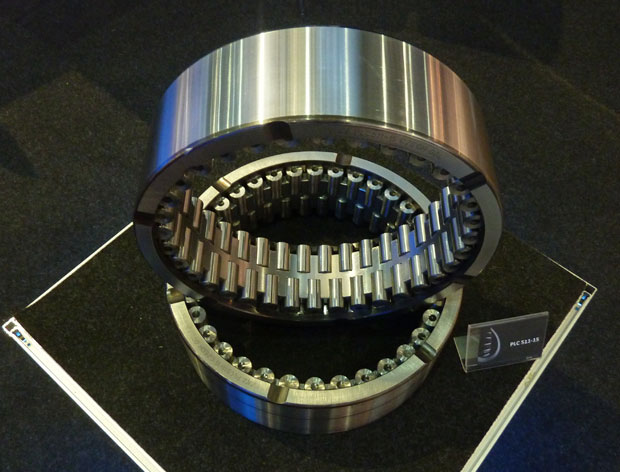

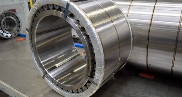

Apart from the actual innovation of this standard assortment of bearings, ZKL has been introducing various novelties to its customers. For example, the company has recently produced special, six-line roller bearings with 3 massive brass cages, installed along the inner ring. This NNU6088MB C3 NF bearing has an outer diameter of 650 mm and a total weight of 465 kg. Yet another type of roller bearings that is not available on a regular basis is NU0048M. This bearing is of a very slim design. With its outer dimension of 360 mm, it is only 37 mm wide and it weighs 14.5 kg. One of the bearings with a complete number of rollers is the NSF3016CV P5 NF type, manufactured in a higher accuracy class (P5). While the outer diameter of the bearing is 125 mm, it weighs only 1.5 kg. From among the bearings for railway applications, we can point out the new PLC 410-53/54.2 roller unit, which is formed by two single-line bearings with gaskets and permanent plastic lubricant filling. The bearing unit is designed for mounting axles of the RegioPanter electric units of Czech Railways.
